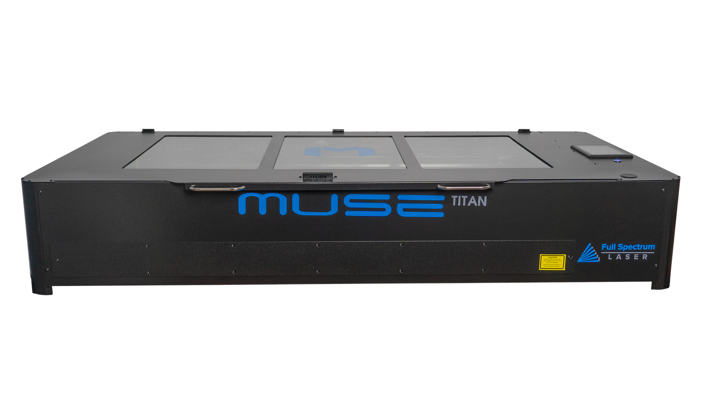

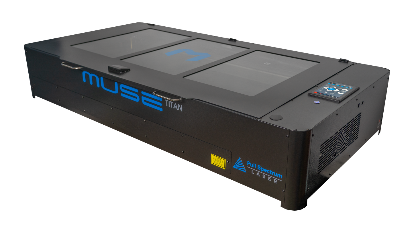

Take your laser cutting and engraving creations to the next level with the large 48"x24" workspace and more powerful laser tube options. Titan comes packed with the latest features including motorized autofocus, patented removable floor, pass through capabilities and more. Best of all the Muse Titan CO2 laser machine is a larger desktop option yet still fits through a standard door. New for 2023 is the Titan v3 with integrated water cooling and steel linear rails on all axes. Improved new precision 3D camera algorithms.

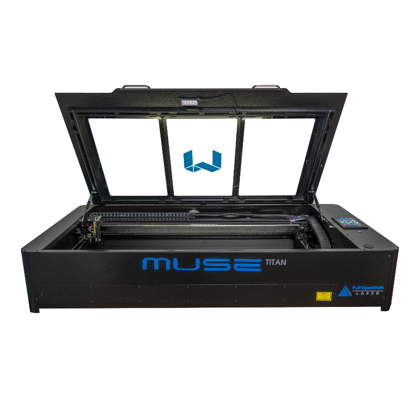

  • REMOVABLE FLOOR - enables users to engrave objects larger than the machine itself
  • FOUR WAY PASS-THROUGH - using the removable floor, the feet of the machine enable material to be fed under the machine on any side
  • FRONT TO BACK PASS-THROUGH - new feature without removing the floor but still feed material 48" through machine
