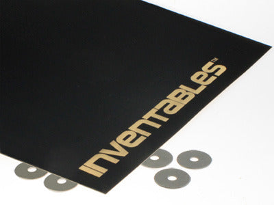

These sheets can be engraved using a 3D carver, like X-Carve or Carvey, as well as a laser cutter.
Carvey Settings
Carving Bit Depth Per Pass Feedrate
1/8" 1 Flute Spiral 0.04" 48"/min
1/8" 2 Flute Straight 0.01" 96"/min
1/16" 2 Flute Fish Tail 0.01" 48"/min
1/32" 2 Flute Fish Tail 0.02" 24"/min
Please note these are intended as ‘a starting point’ and adjustments in 5% increments may be needed to achieve optimal results. When engraving & cutting the .022” thickness a 10-15% reduction in power would certainly be reasonable.
  • Thickness Tolerance (0.022" and 1/16"): ± .003 in
  • Thickness Tolerance (1/8"): ± .005 in
  • Cut Tolerance: ± 1/4"
  • Top Layer Thickness: 0.001"
  • Recommended Engraving Depth: 0.003"
